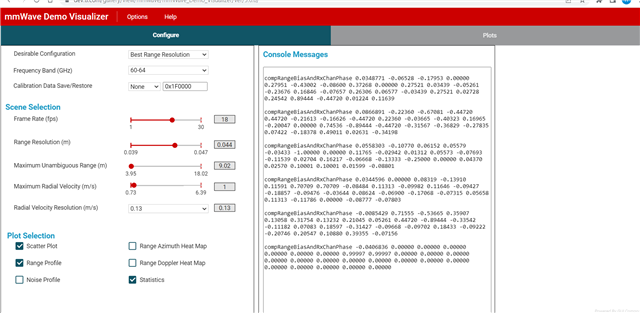

I am doing the range and phase calibration.
Followed the steps as per  //C:/ti/mmwave_sdk_03_05_00_04/packages/ti/demo/xwr68xx/mmw/docs/doxygen/html/index.html. using mmwave visualizer, I tried to get the compensation values. But the values are varying each cycle. Snap of the console messages is attached here for your reference.
Could you help in understanding why the values are varying ?

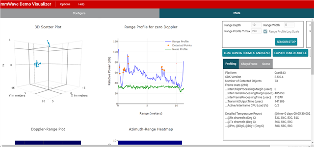

    Can you show the range-plot in the "Plots" tab? Additionally, can you show a picture of your setup? You should have a corner reflector in front of you between 0-1 meters away, and very little else in the environment. Is this the case?

    I am attaching the snaps of range plots .
    I have used 3.2inch corner reflector at 1.6m from the radar (AWR6843AOP) at bore sight.

  • Hi Resmi,
    Do you have the measureRangeBiasAndRxChanPhase 1 X D command in where X is 1.6 meters and D is sufficiently large?

  • Hello Nate
    I gave the command  measureRangeBiasAndRxChanPhase 1 37 1.6  , where 1.6 is the actual range and 38 is the range bin at which the peak is coming.
    let me know whether this is correct command to give.
    Resmi Johnson
  • Hi Resmi,
    The docs appear to tell me that the second argument of X (what you have as 37) is in meters, which may be your problem? Do you see conflicting documentation saying it's in units of range bin #? Additionally, the docs say the second argument (37 in your case) is the range the reflector is based at, and the third argument (1.6) is the window around it. Perhaps try running something more along the lines of
    measureRangeBiasAndRxChanPhase 1 1.6 0.2

  • Hello Nate
    As per your suggestion, I gave the command (measureRangeBiasAndRxChanPhase 1 1.6 0.2) , and iIam able to get a consistent output for calibration values. I have a few queries here:
