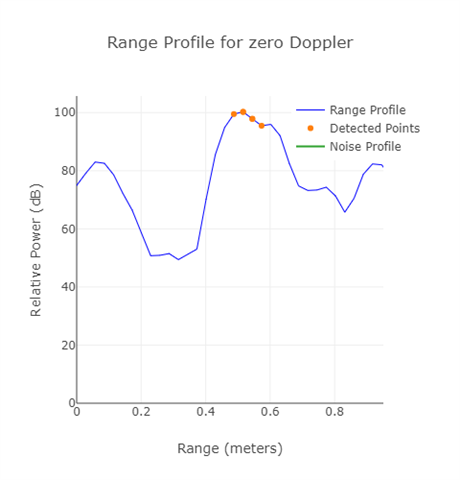

I have two questions.
Q1.In what step is AWR1843 performing object detection?
For me, after the CFAR algorithm, I will detect objects that meet the conditions in the Range Doppler Matrix.
Is it correct to understand that what is detected as an Object is output as coordinates by AoADoppler processing?
Q2.About the measurement of AWR843
I sent the radio waves perpendicular to the floor. (using AWR1843Boost)
AWR1843 was placed 43 cm above the floor.
In the cfg file, both Doppler and Range were disabled for grouping, but Range Profile had peaks at 49 cm, 52 cm, 54 cm, and 57 cm. (52 cm is the highest peak.)
Is there an error of about 10 cm depending on the object?
By the way, I got the following result.
