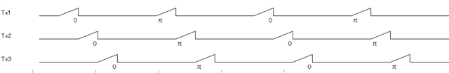

Using the IWR1843 Demo code that comes with SDK 3.5.0.4, I want to change the transmission phase for each chirp as shown below.
It seems that it can be achieved by using subFrame, but there is a constraint of InterBurstBlankTime (min 500us?), and I am looking for a way to shorten the chirp interval as much as possible.
Please let me know if there is a better way to achieve transmission phase switching.

    Can you use the TXPhaseShifter argument? You could make two profileCfg lines and include them both in a single chirpCfg line in the configuration file. Based off https://www.ti.com/lit/an/swra553a/swra553a.pdf, you should only need 50 usec between bursts, not 500 msec. Where do you see that number?

    What I want to achieve is to switch the transmission phase for each chirp, as shown in the thread's first figure.

  • Hi Hiroyuki,
    I do not believe that you need to use the subframes here. I think you can achieve what you're looking for by declaring two profileCfg lines and adding them to the same chirpCfg. Below is my best approximation of what you could do. I started with the profile_2d.cfg file located in C:\ti\mmwave_sdk_03_06_00_00-LTS\packages\ti\demo\xwr68xx\mmw\profiles and I've commented to indicate the relevant changes. This exact chirp profile is untested, but the methodology is how I would recommend designing your chirp.

    I created the following configuration file based on the information you provided and tested it, but an error is returned after sensorStart.
    mmwDemo:/>sensorStart
    Debug: Init Calibration Status = 0x1ffe
    Error -1
    Firmware used in testing: mmwave_sdk_03_06_00_00-LTS/packages/ti/demo/xwr18xx/mmw/xwr18xx_mmw_demo.bin
    Am I doing something wrong?
    Is it possible to test the operation?

    Apologies for the confusion. The cfg shown above was not meant to be an exact working snippet. It was just meant to illustrate the changes described. You can put your device in debug mode to find the source of the error. I would be willing to bet it has to do with the timing of the frameCfg.
