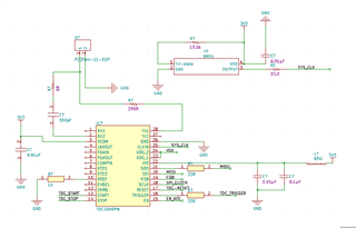

I have this circuit on my PCB:

But I can't get a pulse on TX pin or RX_pin
I configure the TDC1000 with the indicated parameters, I change the EN_pin to high, I make high and low on the trigger pin. But the only thing I have is the infinitely high TX_pin. (I don't have a pulse similar to the datasheet example).
I don't understand what I could be doing wrong.

    Have you ensured that the EN pin is high when you provide the trigger signal? If the EN is low then the device will not generate the pulse on the TX pin since it will remain in a SLEEP state.
    Just taking a quick  look at your hardware there are some components that are missing and some recommendations that I would make:
    • VDD we typically recommend some capacitors to ground to ensure a clean supply
    • VIO I am not sure what the purpose of the resistor is here, the EVM uses a ferrite bead to make sure noise does not couple into the supply
    • Lots of components and connections missing on the RX path (LNAOUT, PGAIN,PGAOUT, and COMPIN) but this shouldn't affect signal generation on the TX pin
    • RREF wont be needed if RTD pins wont be used
    • Clock is 8MHz divided by 32 which yields 250kHz, there is too much of a difference here for a 300kHz transducer here signal might not generate appropriately depending on the transducers limitations.
    I have 0.01uF and 0.1uF decoupling in VDD, but I forgot to show it in the circuit I posted.
    Will it be enough or do you recommend more capacitors?
    VIO I am not sure what the purpose of the resistor is here, the EVM uses a ferrite bead to make sure noise does not couple into the supply.
    I have a ferrite bead, this is not a resistor. It's a Sunlord GZ1608U600CTF ferrite.
    Lots of components and connections missing on the RX path (LNAOUT, PGAIN,PGAOUT, and COMPIN) but this shouldn't affect signal generation on the TX pin.
    I understand, I'll try to improve that part. At this moment I have mounted a 1nf capacitor between LNAOUT and PGAOUT. But I will better the filter in COMPIN.
    I understand, but since I didn't have another Oscilator at that time and 250khz is still within the wide band of the sensor.

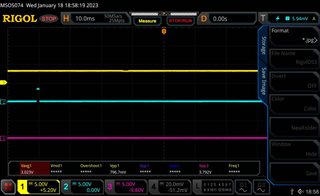

    What I really don't understand for now is why I have no signal on the start pin. I have the EN high and I see my trigger signal. Pic of the oscilloscope follows. But it seems that nothing happens on the start pin.
    Yellon - Enable pin
    Blue - Trigger pin
    Pink - Start pin

    Responses on the hardware:
    1. The 0.01uF and 0.1uF decoupling in VDD should more than enough.
    2. Sorry made a mistake on the ferrite, not sure why I thought it was a resistor initially.
    3. For the interstage passive filters you can try these values, these were for a discontinued version of the EVM that is tuned for frequencies 58kHz to 300kHz.
    4. If the transducer can operate within the 250kHz range then you should be fine.

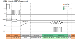

    The pulse generation and START pulse generation both happen in the same state, hence why I am led to believe that the device is not entering the correct state. I have included an image of the state machine the device follows bellow. The two states that I would imagine are the bottlenecks to generate a the pulses would be the EN = high and trigger pulse state.

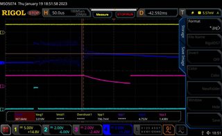

    With a function generator I used a frequency of 1.5MHz and 5v of amplitude. I changed my divisor to 4. That way I can get the 300khz correctly and everything seems to work better.
    Now I have Start signal, the COMPIN pin has signal, but i don't understand if signal is normally.
    I analyzed together the TX/RX signal at this point.
    These are the signals I currently have on my oscilloscope.

    This could be due to the way you are configuring the listening window. The receiver path on the TDC1000 only becomes during the echo listening period that is configured on the device. This is changed by using the SHORT_TOF_BLANK_PERIOD, TIMING_REG, AUTOZERO_PERIOD, and the TOF_TIMEOUT_CTRL registers. The ones you use depend on the TOF Measurement mode you are using and the mode you use depend  on the distance you are measuring along with the expected speed of sound in the medium you are transmitting.
