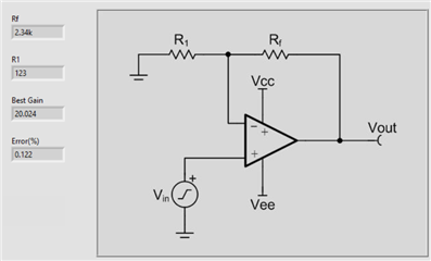

    One further question please.  If the O2 sensor has 10K impedance (DC Resistance) and I like to interface it to an op amp with gain of 20 to 21, would it matter what input and feedback resistor I use.  For example, can I use 10k and 200K, or preferred to use 1K and 20K.  Is there an advantage of using one over the other please?

  • mmsya,
    There is always a reason to select one value over the other. In this case you really would not see much difference.
    The lower the resistor values the higher the bias current in the amplifier. High bias current even if only a few mA's can cause linear error. To high of resistor values and you will become sensitive to noise influences.
    The rule of thump is to try to balance the bias input currents on the positive and negative inputs unless you have a reason to do otherwise.
    The image below is the true ratio you need to get 20x. Do not use 123 Ohm resistor, the values are for setting the ratio so get as close as you feel the need.. Since you have a probe with a 10k impedance use a 12.3k resistor and a 234k resistor. In this application you are not matching impedances you are balancing the bias currents.
