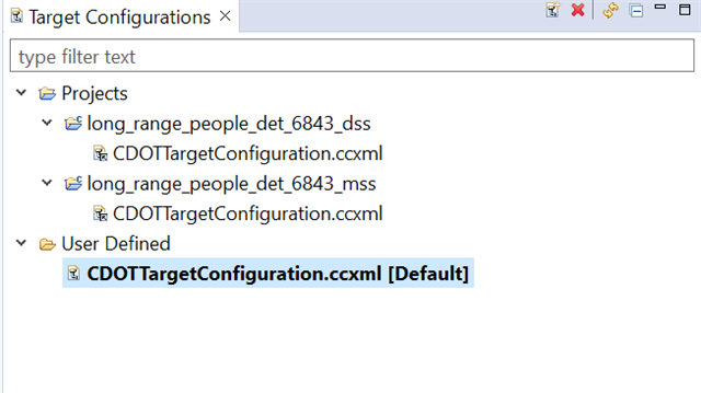

  • It's not clear how I need to setup the target configurations for the debug configuration so that I can debug the dss and the mss at the same time - or load the code for the dss while I debug the mss.  I had previously assumed the debugger was already doing that when I selected the IWR6843ISK in the Target Configuration and it included both CPUs:
    clicking on debug with the mss portion of the project selected I'm able to run the code - but it indicates that the debug probe for the C674x is disconnected.

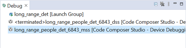

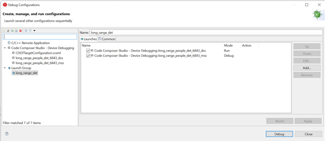

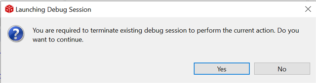

  • I've tried under Debug Configuration to setup a launch group to 'Run' the DSS, and Debug the MSS:
    But I get this message about terminating the existing debug session as it sets up:
    And it won't setup debug for the MSS after that.  Running the debugger with the default ccxml seems to be the only thing that works.
    Even though I have Debug and Run setup in the Common tab:
    I get nothing on the task bar to actually start and stop the debugger with, and the DSS debug session is terminated:
    -TomG.

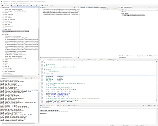

  • I couldn't get the launch group to work, so maybe that's not what that functionality is for.  However, it looks like I was able to get it setup but there were several steps that I was unaware of.  The best resource I could find on this was at: IWR6843: Debugging overhead_3d_people_count_68xx_mss failed - Sensors forum - Sensors - TI E2E support forums
    So, using the Default configuration ccxml for the MSS code after compiling and resetting the target board, and then clicking on 'Debug', I get both of the Debug Probe for the Cortex_R4 and the Probe for the C674X.  I then Connect to the Target on the C674X, and then using the load icon, point it at the DSS project and it's xe674 binary.  I then hit run, and then debug runs the MSS project.  It now tells me that the DPM sync task completed successfully (on both side) which indicates that the DSP is communicating properly with us now.  It looks like I can reverse this process to debug on the DSP while the MSS runs.
