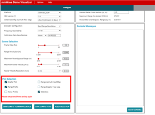

I wonder If there is any way to get the 2D Scatter Plot (X-Y Scatter Plot) instead of the 3D Scatter Plot with the AWR1832AOP in the mmWave Demo Visualizer since I'm only interested in the Azimuth information for now.
I need this plot
Instead of this one
Thank you in advance.

Hello Kim,
If you run ods_3d_visualizer.exe provided as a part of lab 14 in the automotive toolbox (C:\ti\mmwave_automotive_toolbox_3_6_0\labs\lab0014_obstacle_detection_aop) after the binary file has been burnt, the pin configuration changed, and the device reset, you can choose which view you want from the list of drop down options given in the image below
If you are running the example through the mmWave studio Visualizer then in the Configure Tab of the visualizer once you have completed Setup Details and Scene Selection, there is an option Plot Selection that lets you choose what kind of plot you wish to see at the output. Choosing the correct option will let you see the Azimuth plot
I'm aware of that, but changing these settings don't give me the exact same plot which I've pointed out in the beginning.
