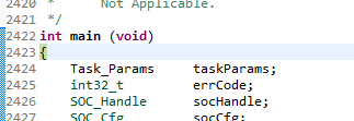

I'm trying to debug the OOB Demo for IWR1443 with IWR1443BOOST. For that purpose, I've followed the instructions described in Using CCS Debug for Development (as recommended in the Demo User guide). My problem is that I don't manage to set breakpoints. For this application, I'm trying to set a breakpoint on the CLI_task, at the moment where it prints the banner through the CLI port. I try to activate that breakpoint and CCS gives the following error:

After doing all of that, the debug stops on the first breakpoint (auto-established by CCS) on the first line of main(), as follows:
Then, when I press the resume button, it prints the CLI banner through data UART  (so it means it runs the line code at which I'm trying to set my breakpoint) and does "nothing" apparently. If I pause it I can see it has gone to sleep mode, waiting for interruptions:
To sum up, what I want is to understand what could I be doing wrong when trying to establish my breakpoints at CCS (if I should include some symbols I didn't consider; if that's the case, how should I do it; if the root of the error is someplace else...)

  • Hello Julia,
    Below I have added a breakpoint right before the CLI banner and CCS successfully stops right before printing it.
    I add the breakpoint to my CLI file (for OOB I believe it should be mmw_cli.c) file after loading the program to the target and before I hit Resume for the first time.
