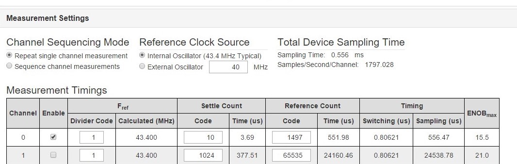

To control the sampling rate, from the example on the datasheet,  the RCOUNT_CH0 and SETTLECONUT_CH0 register are related to control the conversion time and settle time (channel switching delay is treated as solid, 1 us)
SETTLECONUT_CH0 >Vpk * f_REF0 * C * pi^2 / (32 * IDRIVE0), as the Vpk is at the range of 1.2 to 1.8 (in datasheet), f_REF0 uses the internal clock (40Mhz?), the calculated SETTLECONUT_CH0 would always be smaller than 8, and select 10 for some system clearance, so that the register value is 0x000A
And also we have the settle time ts=SETTLECONUT_CH0 *16 / f_REF0= 4us
 so the ideal conversion time tc should be set as (1e-3 - 1us -4us) = 5.99 e-4 s, as tc = 16* RCOUNT_CH0 / f_REF, the decimal RCOUNT_CH0 = 1497,  and the register value should be 0x05D9
Besides, the CLOCK_DIVIDERS_CH0 = 0x1001
MUX_CONFIG=0x020D, CONFIG=0x1C01 for single CH0 repeat scanning.
I only make these change in register via python, and I can see this values all have been changed via GUI configuration interface, but once I start the loop, the logging data would always be collect with 100hz, if it is due to my computer limit, after I change the sampling ratio to 50 hz, the logging data frequency still has no different.
It looks even I change the register values, I cannot shift this evm board sampling rate, and the sample ratio from the python is always 100hz, or probably I missed any CLOCK settings? Can you give me some suggestions?

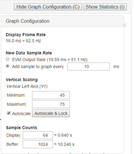

following pic is the GUI screenshot after I run the code in Python, to show the register does been re-write
    Two questions for you one this:
    1. When you are reading data through python, how are you getting the data from the EVM? The streaming command or by reading the registers individually?
    2. When configuring the data graph in the GUI, what value appears in the graph configuration if you change the new data sample rate to EVM output rate?

    and for the GUI graph configuration, with this 1797.028hz setting, during the streaming the evm can only achieve around 50 hz maximum output rate
    Thank you for the additional information. I have a couple notes for your timing calculations:
    • The internal clock of the FDC2214 is a 43.4MHz typical value for calculations:
    • The oscillator included on the EVM is a 40MHz clock. This is what would be used if you set the device to external oscillator
    • You are configuring the device for single channel mode so there will not be a switching delay. After the first sensor activation (determined by settle count), the sensor will oscillate constantly while conversions happen.
    • Additionally, the fref that you use for calculations is after the clock dividers. Yours is currently set to 1 so it matches the clock in.
    • Lastly, for single channel mode, it is recommended to keep fref < 35MHz:
      • You may need to consider changing your clock divider to 2
    For the python code, one thing you can do to verify your sample time of the device is to create a loop that writes down the time everytime the DRDY bit of the STATUS register is high. Instead of streaming the data, doing an individual register read and polling for this bit will give you the actual conversion time of the device. This is a good way to double check the expected value for your data collection.
