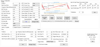

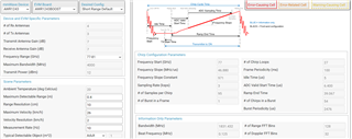

I am working with AWR1243BOOST and DCA1000EVM, I have a question about radar configure maximum range.
I refer mmWave Sensing Estimator and try configuring radar in Short Range (range resolution: 10 cm, max range: 40 cm), but configure sensor mmWave Studio, max range detection not in 40 cm (Range-Doppler heatmap).
 mmWave Studio
So, Can AWR1243BOOST working in short range (10~40 cm)?
Is my sensor configuration being correct?
