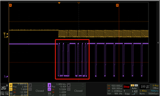

I2C can't communication with below code and attached fig, kindly help where issues happened ,thanks.

int8_t user_i2c_read(uint8_t i2c_addr, uint8_t reg_addr, uint8_t *buf,
uint8_t len)
i2c_cmd_handle_t cmd = i2c_cmd_link_create();
i2c_master_start(cmd);
i2c_master_write_byte(cmd, (i2c_addr << 1) | WRITE_BIT, ACK_VAL);
if (NULL != reg_addr)
i2c_master_write_byte(cmd, reg_addr, ACK_VAL);
i2c_master_write_byte(cmd, (i2c_addr << 1) | READ_BIT, ACK_VAL);
i2c_master_read(cmd, buf, len, ACK_VAL);
i2c_master_stop(cmd);
esp_err_t ret = i2c_master_cmd_begin(I2C_MASTER_NUM, cmd, 1000 / portTICK_RATE_MS);
if (ret != ESP_OK)
ESP_LOGE(TAG, "read_i2c_master_cmd_begin failed");
return ret;
i2c_cmd_link_delete(cmd);
return ret;

void user_opt3001_device_id(void)
uint8_t data[20] = {};
ID = user_i2c_read(OPT3001_SLAVE_ADDR, OPT3001_DEVI_ADDR, data, 10);
ESP_LOGI(TAG, "device_addr data :0x%x,%x", data[0], data[1]);
ESP_LOGI(TAG, "device_addr data :0x%x,%x", data[2], data[3]);
ESP_LOGI(TAG, "device_addr data :0x%x,%x", data[4], data[5]);
ESP_LOGI(TAG, "device_addr data :0x%x,%x", data[6], data[7]);
ESP_LOGI(TAG, "device_addr data :0x%x,%x", data[8], data[9]);
