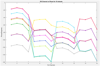

We're using a custom cascade RF board which is designed as per the guidelines given by TI to design a 4-chip cascade board.
We're using mmwave studio to collect data and as per this guide (https://www.ti.com/lit/an/spracv2/spracv2.pdf), we have generated a calibration file in a clean environment for each board(TI cascade board and custom cascade board board) and we're restoring it after configuring the board to capture data.
We have a corner reflector kept at boresight, outside the far field distance, in front of the radar. We're capturing data through mmwave studio, power cycling the radar, and capturing it again after configuring it and restoring the calibrations. This sequence is repeated 10 times. The first 3 frames are ignored, as per guidelines and the 6th frame is plotted for each file, which has 10 frames in total. The same configuration and capture LUA script are used for both boards.
This photo shows how the phases look when we use the cascade board

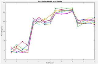

This one shows the Rx phase for our board
As you can see, the phases between reboots with the TI cascade board, although varying, are following a pattern. But from the custom board, it looks to be all over the place.

3. In the first photo, why does the phase of RX channels from any one AWR seems to change upon every reboot?
4. The phases of the Rx channels, for a single target at boresight, should ideally be the same, but it's not. is this expected?

    At first, all the boot-time calibrations are enabled, and the radar is made to go through the rf_init cycle, which executes these calibrations on boot and generates 4 binary files(1 for each AWR) which are stored in NVM. The radar is made to chirp, and ADC data is captured of a Corner reflector kept at boresight at the far field. The calibration binary files generated are parsed to ensure the status bits are all set to 1, indicating successful calibration.
    For subsequent reboots(or power cycles), all the boot time calibrations are disabled(as advised by the ICD), and the binary files are fed back to the AWRs before rf_init. The AWRs "restore" the calibration files and proceeds to chirp.
    We collect ADC data again and compare the phase difference between the receivers, and between power cycles. As you see in the photo I posted above, after every 4 receivers the phase jumps randomly, meaning the 4 AWRs chips are not synchronized with each other.
