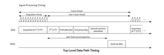

  • Thank you for the additional information.
    Please take a look at the following picture
    The Frame Period is the Processing time unit.
    There are two main parts in the Frame
    1) Acquisition Time - during this time the ADC data is received for each chirp and the 1D fft is performed for each chirp
    2) Inter Frame Idle Time - during this time 2D FFT, CFAR... processing happens

    The 9 ms correspond to the Acquisition time below. For processing one would need to add Idle time
    what is the maximum and minimum period for inter-idle frame ?
    This will depend on how much processing has to be performed. The processing time depends on the number of chirps and the number of ADC samples.
    The frame period can be as low as 10ms if there are only a few chirps in the frame
    What application are you interested in? What frame rate are you considering?
