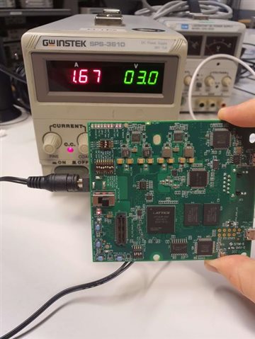

I'm using a DCA1000 EVM, it should be working on 5V-700mA, however once I plug it to a power supply via the jack connector, the power supply shows a drop in voltage, and current needs of about 1.1A - mind you this happens but none of the LEDs on the card light up.
Upping the amps - to around 1.7A, I see the value of 3V on my power supply and at that moment, LEDs do light up- including the "5V-LED".

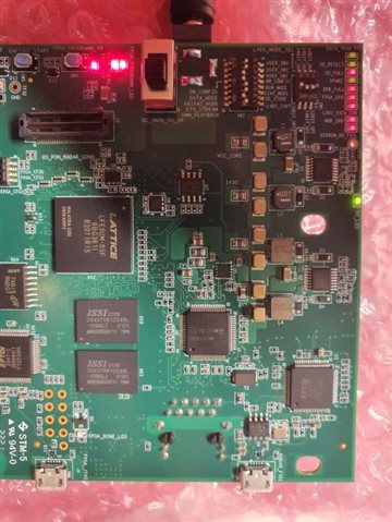

    The heat was mainly on a specific corner of the DCA1000, around the row of LEDs for functional information. We tried looking what components were on this corner, which we think are capacitors and mostly a regulator. We think there is
    either a defect in a component, most likely the regulator in question, or we are using the card in a majorly wrong way.

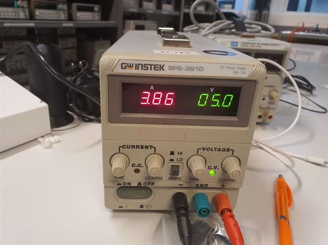

    Thank for your answer, the problem is that, to get to 5V, I need to be around 3.95-3.85 A, not 3A... Also, basically all the LEDs possible are lighted up as it is powered up.
    On Table 10, and Figure 18, ALL the LEDs are lighted up, even though there are for instance no SD card inserted, I'm not pressing any FPGA button, no nothing. Speaking of FPGA, there are also LEDs for "FPGA_INI", "FPGA_RST" that are lighted up in red. Again, even sending less current than 5V (for instance 3V, 1.5A) will light up the "5V_LED". To explain further on that point, before plugging the DCA1000, my bench power supply does show 5V, but as I said the voltage drops. This is of course only plugging the DCA1000 and it being plugged to nothing.

    So this is when I'm trying to get 5V. At this point in time, the DCA is heating, specifically, the component close to the row of LEDs I told you about, which I read on is a "L24600 YMH", which is a "Wide Input Range Buck Regulator".

    - At 3V/1.7A, the LEDs still do light up, but my power supply indicates there isn't enough current for the card (C.C. indicator, photo incoming). No heat, maybe a slight amount.

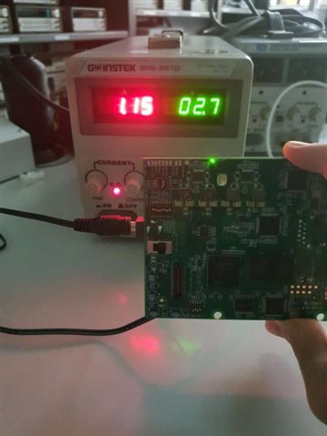

    - From 2.4A/0.8A to 2.8V/1.4A, only the 5V_LED lights up, which is already concerning on its own. Still having the CC indicator on my power supply (Contrast wasn't really good so I turned off the lights on the picture I took).

    After more details were given offline, I consider this card defective.
