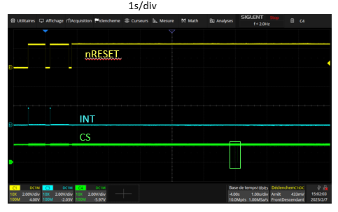

Now, here is we measure the signals on an own design :
Own radar 1
First difference with the automotive reference design : the level of the two first rises is high and not intermediate. We notice that SPI INT goes high for a very short time with the 2 first NRESET rises, but remains low on the third NRESET, which is the "real" start signal of the chip.
Question 2 : What is the condition for the SPI INT to go high when NRESET is pulled up  ?

  • Hello Swati,
    SOP2 is driven to 0 just before nRESET is pulled up, but to be sure we're booting in [0 0 1] SPI functional mode, we connected it to GND. We now see  INTR SPI going up nRESET:
    However, we still have nothing coming from the chip on the MISO SPI :
    On the automotive reference design, we see MISO and MOSI signals coming immediatly after nRESET goes up. In our design, we only see MOSI coming from host.
    Does Warm_reset going down and SPI INTR going up implies that the chip correctly boots ?
    Also, we noticed that our nRESET voltage level is 2.5V compared to 1.8V on the reference automotive radar, probably because we didn't put a resistor that they put on this line. Both are in 1.8V VIO mode. Could this lead to the problem we're dealing with ?
    Jeff
  • Hey Jeff,
    From the picture shared above, it seems that the IOs in your design are not getting the correct power. The signal level of the MOSI line looks to be less than 500mV, which is less than the VIH for 1.8V, hence could be the reason why there is no signal at MISO line.
    Moreover, having the nRESET at 2.5V violates the Absolute Max Rating of the VIOIN_18 mentioned in the AWR2243 datasheet. Yes, it could be a reason for the problem you are facing. I would also recommend checking the other 1.8V pins and ensuring that they are also at the correct levels.

  • Hello Swati,
    we checked the pins. We did some modification to add a few voltage divisors as they did on the reference automotive radar : nRESET, SOP2, RS232 and nERROR_IN. We now have nRESET at 1.8 :
    nRESET now has the same level as ref design. However, after modification, WARM_RESET doesn't go down anymore after NRESET is up :(
    Also, we can see that OSC_CLOCK_OUT is coming after 645 ms on the automotive radar, which is much more than 7 ms as written in the documentation (but the radar chips are working) , whereas it's always present on our version as soon as nRESET is up. Do you have an idea of what may cause this ? A problem with the XTAL ?
    Moreover, during the verifications we made, we noticed that we didn't connect these 3 output pins : VOUT_14APLL, VOUT_14ASYNTH and VB_GAP. On the reference design, they have decoupling capacitors to GND.Can this cause our problems ?
    I guess we're close to make it work, but there's something we did wrong that we don't see.
    Jeff
