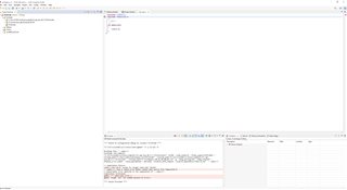

Hello, I'm attempting to create a program that detects people and to do this I want to use the mmwavelib.h file from the mmwave SDK. So, when adding the code line: #include <mmwavelib.h> at the beginning of my main.c file i run into the error "fatal error #1965: cannot open source file 'mmwavelib.h'" When seeing this, I attempted to copy and paste the entire file path of the header file and that would then prompt me with this error, "Line 131: fatal error #1965: cannot open source file 'vect.h'". When opening the mmwavelib header file within Codeblocks I see that vect.h is another header file within the mmwavelib header file that is typed as "#include <vect.h>. I had also spoke with Ti's tech support who had told me to try and put the packages folder from the mmwave SDK in the include options of the CCS project. I had done that and still have encountered the same error and tried to solve this by including other folders into the include options. I have included the error files mentioned and I have also added a screenshot of all of my include options as well as the general project configurations. I'm not sure what more I can try here, so any help would be much appreciated thank you.

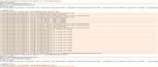

  • If I understood correctly, for every source file error like above I am to find said file, copy paste it to the workspace and then rebuild. I have done this until I arrive at the same error but now with the file c6x.h and when attempting the same method of copy pasting I then receive a multitude of errors. The first error is the same kind just with another file named mmwavelib_fft.h however everything after that are when the IDE attempts to build other C files that cannot be built because there are multiple identifier errors centere aruond "__int40_t" being undefined I will include a screenshot of the errors. I'm not sure what other header or source file I would have to include as looking through c6x.h I only see one include file being vect.h which is already included in the workspace and adjusted accordingly in c6x.h. Is there anything else I should try or if I even have to include all of these files before beginning my code?

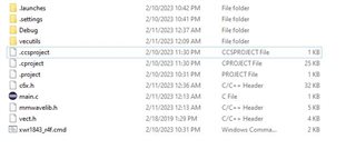

    P.S. I have also included a screenshot of my workspace with the files (and folder) that I have included thus far.
