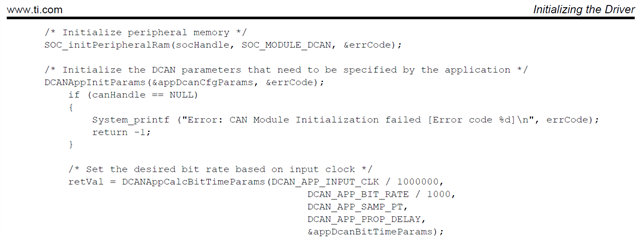

Hi Team,
I am currently using the lab0002_short_range_radar in mmwave_automotive_toolbox_3_6_0 for development and add CAN code in accordance with the following example.
https://www.ti.com/lit/an/spracg9/spracg9.pdf?ts=1676271953707&ref_url=https%253A%252F%252Fwww.ti.com%252Fproduct%252FAWR1642%253Futm_source%253Dgoogle%2526utm_medium%253Dcpc%2526utm_campaign%253Depd-null-null-gpn_en-cpc-pf-google-tw%2526utm_content%253Dawr1642%2526ds_k%253D%25257b_dssearchterm%25257d%2526DCM%253Dyes%2526gclid%253DEAIaIQobChMI3KmVw_eR_QIVzlBgCh2zbQ90EAAYASAAEgKiFvD_BwE%2526gclsrc%253Daw.ds
https://www.ti.com/lit/an/spracf7/spracf7.pdf?ts=1676274810242&ref_url=https%253A%252F%252Fwww.ti.com%252Fproduct%252FAWR1642%253Futm_source%253Dgoogle%2526utm_medium%253Dcpc%2526utm_campaign%253Depd-null-null-gpn_en-cpc-pf-google-tw%2526utm_content%253Dawr1642%2526ds_k%253D%25257b_dssearchterm%25257d%2526DCM%253Dyes%2526gclid%253DEAIaIQobChMI3KmVw_eR_QIVzlBgCh2zbQ90EAAYASAAEgKiFvD_BwE%2526gclsrc%253Daw.ds
But I encountered many problems meanwhile, such as the parameter 'undefined' in the function.
I would like to know
1. How to define these parameters (socHandle, DCAN_APP_INPUT_CLK, DCAN_APP_BIT_RATE...)? Is there any documentation available for reference?
2. Is it feasible to observe whether AWR1642BOOST has transmitted correct data through CAN analyzer?
ex.
If it is possible, is there a sample project or sample code that can transmit data through CAN? (I have tried lab0005_object_data_over_can, but it cannot work normally.)

    The examples provided in the documents mentioned use probably older versions of the SDK.
    You would need to make the updates for the SDK being used.
    The
    mmwave_automotive_toolbox_3_6_0\labs\lab0002_short_range_radar uses the SDK 3.5 as mentioned in the release notes.
    The canfd unit test provides an example how to initialize the can driver
    C:\ti\mmwave_sdk_03_05_00_04\packages\ti\drivers\canfd\test\xwr18xx\main.c
    This example shows how to initialize the CAN FD driver for SDK 3.5
    Regarding the "lab0005_object_data_over_can" this lab has been tested and it is working.
    It supports SDK 2.1.0.4
    mmwave_automotive_toolbox_3_6_0\labs\lab0005_object_data_over_can
    The canfd unit test included in SDK 2.1.0.4 also shows how to init the canfd driver with this SDK
    C:\ti\mmwave_sdk_02_01_00_04\packages\ti\drivers\canfd\test\xwr16xx\main.c

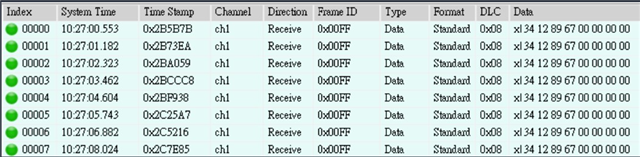

    In addition, I would like to whether the role of the sample code 'C:\ti\mmwave_sdk_03_06_00_00-LTS\packages\ti\drivers\canfd\test\xwr16xx\main.c' is to transmit the following data through CAN bus?
    Katherine
    Yes, this data is transmitted through CAN. However these are loopback examples
