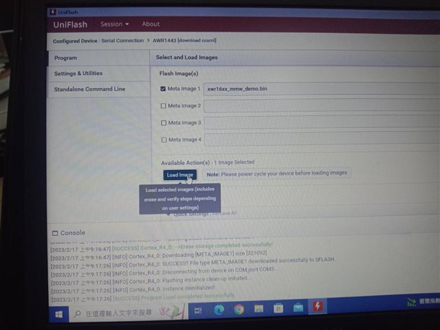

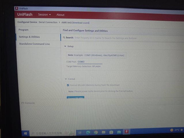

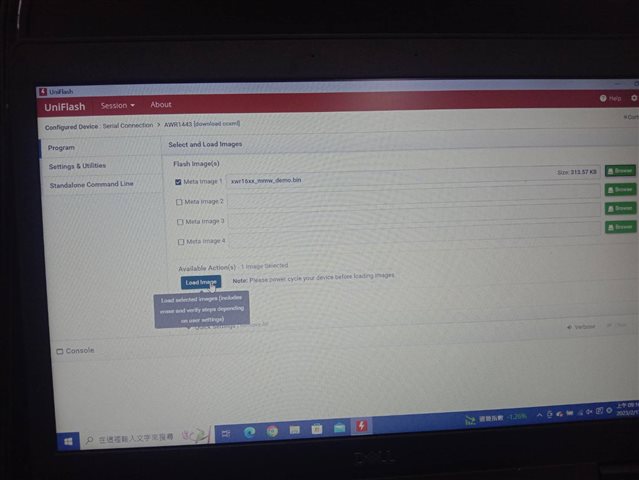

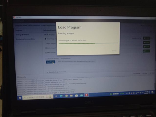

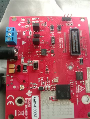

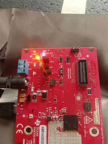

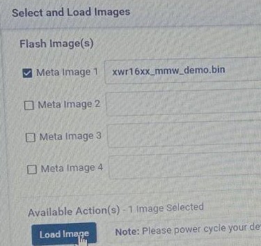

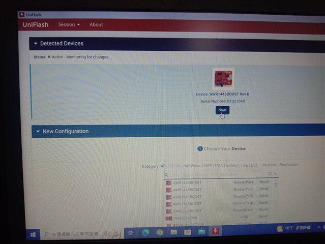

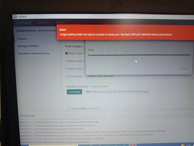

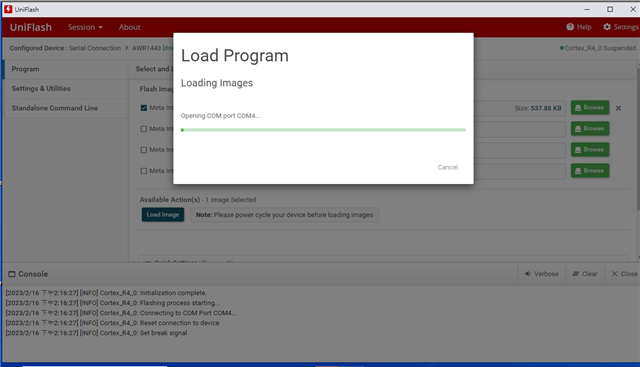

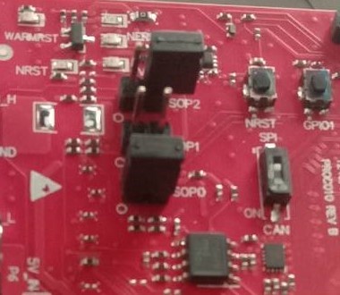

SOP2,1,0 jumper is 0,0,1 and I pressed the NRST button on the device.
(1,0,1 would lead in "waiting data")
The left down side of mmWave Demo Visualizer: Hardware connected not "waiting data".
"SEND CONFIG TO MMWAVE DEVICE" and then no response ( no console messages, no plots )
Thank you for your help.
