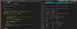

  • Hello again,

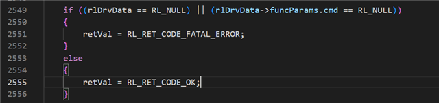

    Using breakpoints, are you able to determine exactly which line of code causes the failure? For example, if one of these variables are null an error will occur. Can you check if either of these are null (rl_driver.c)?
    I've just checked this, apparently the error is there because the code ultimately fails on the while loop of line 2562:
    while ((deviceMap != 0U) && (RL_RET_CODE_OK == retVal))
    I'm not able to confirm if any of the variables you mention is null as the variable "rlDrvData" does not show in the Variable window and the debugging session gets worse in this section (switches randomly to other previously called functions).
    But actually line 2547:
    rlDriverData_t *rlDrvData = rlDriverGetHandle();
    Doesn't even appear in the disassembly as you can see below, so I guess "rlDrvData" is null?
    I'm still looking into this. Please expect a response on this tomorrow afternoon (CST).
    If the execution is seemingly jumping around it's likely due to compiler optimization. This can be disabled in CCS for your whole project or individually on a per file basis.
