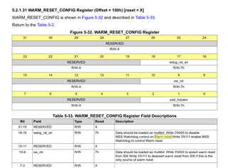

    If you want to perform a reset to start from the RBL you will have to perform a soft reset from the software:
    You can refer the TRM for the above mentioned section.
    Also use the latest SDK 4.3.0.1 for performing the warm reset as previous bugs related to the same have been fixed.
