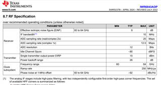

In one project, we placed a dielectric lens on the IWR6843ISK to improve the directivity of the system.
Now, I would like to measure the radiating pattern of our system to validate it and to be sure that we will be able to do that, I need some information :
- I saw in the datasheet that the output power of the AOP evaluation board is 10dBm. Is it the total power obtained on 4 GHz or the power at a single frequency ?
- In dev.ti.com/.../node I saw that you measured the radiating pattern of Tx-Rx pairs and never of a single Tx or Rx antenna. Is there a reason for this ?
- Finally, Is there a way to generate a single frequency signal with the IWR6843AOP board to facilitate the measurement method?
