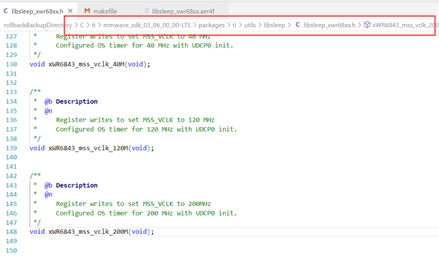

    If they needs to change the operating frequency of the MSS system to optimize power consumption, such as the modification function for MSS_VCLK in the libsleep packaged in the SDK:
    The customer needs to implement the same change as this function, which is that one of the values in MSS_VCLK 40-200m can be changed to meet the power consumption needs of the actual project after evaluation. However, currently there is no customizable function available in mmWave_SDK to meet this requirement.
    So they are going to locate these two fields on MSS_VCLK_DIV and _SEL in the register function field, wondering if it is possible to support this function to reconfigure MSS_VCLK, like in libsleep? This configuration process requires information about the status of the system. Because MSS_VCLK is the operating clock for the MSS subsystem, certain configuration prerequisites and configuration logic need to be met.
