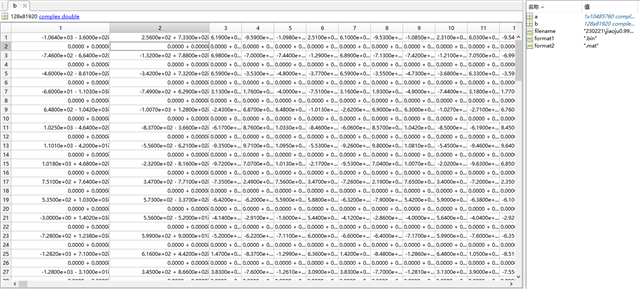

Besides, what is the difference between the IQ of the receiver? Is one a real number and the other an imaginary number? Then when I use the data later, do I need to combine real and imaginary numbers together? But I notice that the data I collected are actually in plural form, and there will be a row of Chirp data with values and row of Chirp data without values. Then the amount of data is still twice the value set. It's shown below.
I am using the Complex 1x mode. The ADC sample is 256, the No of chirp loops is 128, and the No of frame is 160. Thus, the calculation should involve the 5,242,880 complex values, right? If the IQ is separated, it will be doubled. But there is no separation here except for the fact that one row is vacant.
Could you tell me the reason for this?

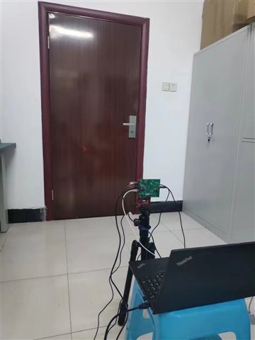

The code for parsing the bin file I used is also attached here. Could you please help me check if there is any error? Thank you.
