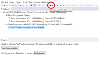

    Thank you for giving a detailed account of the steps you've taken. This is very helpful for me to assist you in resolving the issue. Couple of notes:
    • There is no need to flash the 'hello_world.debug.appimage' to the device before beginning the debug procedure. The program will be loaded to the device in CCS using 'hello_world.debug.out' file. However, I do not believe this is what is causing the problem you are seeing.
    • I apologize about the confusion regarding the images in the pdf guide. The images were likely taken from a previous version in which the target configuration file used showed both the M3 and M4 cores. The current target configuration does only show the M4 core so you have nothing to worry about there. Thank you for pointing this out, we will update the images in the guide for improved clarity.
      • The on pages 7 of the '8132.xWRL6432_APL_CCS_debug_guide.pdf',
            After that, I can set the image below the fig3
            I think that this is so strange
            Could you check it?
      This is also expected after connecting to the M4. No issue here.
    It seems that I have been able to replicate the error that you are seeing. All of the steps you have listed so far are correct besides the first step which is unnecessary. I believe the error may be occurring based on what you do next after this point. Once you have connected to the M4 (fig. 3) you must reset the CPU, this can be done with the keyboard shortcut Ctrl+Shift+R or by clicking on the circled icon in the image below.

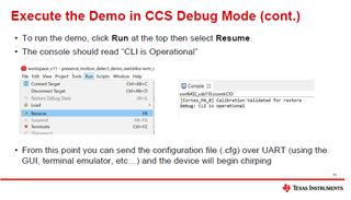

    After resetting the CPU you can follow the remaining steps in the pdf guide. Starting with loading the .out file. The pdf guide references the Out-of-Box demo (Presence and Motion Detect) but the same steps can be used for debugging the hello world example.
    I hope this helps! Please let me know if this does not resolve your issue.
    Josh
