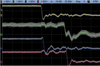

  • This is a capture of our timing signals (two pairs):
    The probe setup here wasn't super clean, so the signals look worse than they actually are.  They have fast edges, but not enough voltage swing for the TDS7200 input high min of 0.7*VDD.  We intend to use 3.3V, so this is 2.3V, while our timing signals are approximately 1.2V.
    We need digital level translation, but I think comparators with tight propagation delay tolerances would work great.  Do you have suggested parts?  Probably a dual with matched propagation delays through the comparator?

  • Hello Jason,
    Thanks for the info here. I am assuming the signals in your scope capture are the signals directly from your sensor. I think a comparator might work better in your application because you should be able to configure at which level to output your stop START or STOP signal. You might be able to get away with a level translator since you mentioned the signals are not as noisy as they are in this scope capture above but I personally prefer the comparator option since you will give the device a cleaner signal. I do not have any suggested parts to recommend here since I service the sensor side of our portfolio.

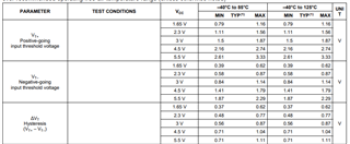

  • Hysteretic inputs are specified with thresholds and hysteresis, like this:
    The TDS7200 just specifies VIHmin and VILmax, with numbers consistent with a standard CMOS input:
  • Hey Jason,
    Technically you can already do this level of analysis, the input low and high levels are functions of V_DD. So if you know your VDD only has a range of 2V-3.6V then you can calculate the min high level and the max low level. The only difference that the TDC720x devices don't have are the max levels don't shift with the input voltage and we just defined as the max Vdd.
    So technically you can say:
    V_DD = 2V    MIN VIH- 1.4V
    V_DD= 2.5V  MIN VIH- 1.75V
    V_DD = 3V    MIN VIH- 2.1V
    V_DD= 3.3V  MIN VIH- 2.31V
    V_DD = 2V    MAX VIL- 0.6V
    V_DD= 2.5V  MAX VIL- 0.75V
    V_DD = 3V    MAX VIL- 0.9V
    V_DD= 3.3V  MAX VIL- 0.99V
    I do agree that the hysteresis could have a better definition, and my theory on this is that when the  TDC720x devices were designed they were designed with TDC1000 specifically in mind, so when it was originally specified the team was not focused on the other applications for this device. Your feedback is appreciated though I will definitely relay this over to the design team when we have our conversation.
