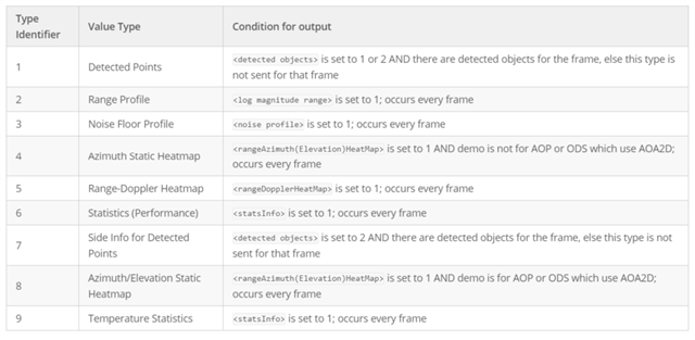

3. When i read the 'Understanding UART Data Output Format' in resource explorer, i find a table
    At type Identifier 4 and 8, I think that I think the difference is between ODS and AOP modes.
    Is it right?
    So, i will use AOA2D, i will take Azimuth/Elevation Static Heatmap

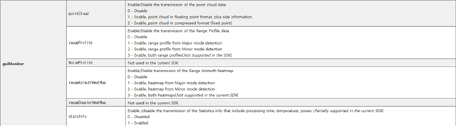

4. In sdk document, i can see 'guiMonitor' parameter
    There is not parameter about 'Azimuth/Elevation Static Heatmap' in sdk document.
    Also, When i check it in source code, i find annotation /* Range-Azimuth Heatmap (Major motion) */
    Which one is right parameter?
        Is it right?
    Sorry about any confusion caused here. These TLVs you are referring to here are part of the output of the Out-of-Box demo for the previous generation devices but are not currently included in the output of IWRL6432 demo. Azimuth static heatmap (type 4) is used for xWR6843ISK whereas Azimuth-Elevation static heatmap (type 8) is used for xWR6843ISK-ODS and xWR6843AOP.
