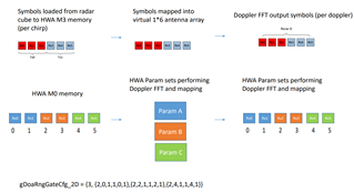

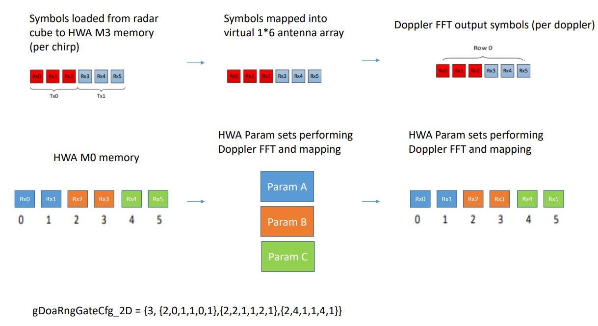

1. I am using the new designed antenna, and from the "MotionPresenceDetectionDemo_documentation.pdf", the parameters of the antenna geomtry needs to be changed. If I change the antenna to virtual 1*6 antenna array, based on the explanation of the document, is the parameter of gDoaRngGateCfg_2D = {3, {2,0,1,1,0,1},{2,2,1,1,2,1},{2,4,1,1,4,1}} correct?
2. Could you tell me where to change the parameter of gDoaRngGateCfg_2D in the motion_and_presence_detect_demo code? Because I cannot find gDoaRngGateCfg_2D in the code.

  • Hi Josh,
    Thanks for the answer.
    I am curious that I saw gDoaRngGateCfg_1D. In my case, this will be suitble, right?
    Also, if gDoaRngGateCfg_1D is applied, what should I change?

  • Hi ChiaChih,
    Yes, you are absolutely correct. gDoaRngGateCfg_1D was used for testing purposes and is not applicable for the antenna pattern on the IWRL6432BOOST EVM but it would be suitable in your case. Your suggested change using 3 paramsets would also work but would be slightly less efficient.

  • Hi Josh,
    1. Sorry that I misunderstand your question.
    Answering the question of "Are you looking for the additional changes required in order to use gDoaRngGateCfg_1D?"
    Yes, I am looking for the additional changes required to use gDoaRngGateCfg_1D.
    Based on the figure, my antenna pattern is 1-D, then if I want to use the gDoaRngGateCfg_1D, is that ok for me just use it directly? or what else should I change?
    2. What do you mean "less efficient" while I use gDoaRngGateCfg_2D in my case? Does this affect the Tx power?
    ChiaChih
  • Hi ChiaChih,
    No problem!
    Yes, you should be able to use it directly; but to be able to use it in the first place you will need to make some minor modifications to the code.
    For instance, Line 456 of file doaproc.c is where rngGateCfg is set based on the value of the procOption variable. You will want procOption = 1 to use gDoaRngGateCfg_1D. To accomplish this you have a couple options:
    1. Use the already defined DPU_DOAPROC_ISK_BOARD for deviceSelect.board. This is set on line 908 of motion_detect.c
    2. Create a new macro for your own custom board using #define. Then add an additional a logical OR in the conditional on line 445 of doaproc.c. So that the same 1D settings are applied for your custom board.
    No, Tx power is not affected. I just mean in terms of number of HWA operations. gDoaRngGateCfg_2D = {3, {2,0,1,1,0,1},{2,2,1,1,2,1},{2,4,1,1,4,1}} will do the same thing as gDoaRngGateCfg_1D = {1, {6,0,1,1,0,1}} but with 3 HWA operations rather than 1.
