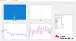

I have to do my experiments with various chirp parameters, which is easy to do with the MMWave Studio. Unfortunately, I get different results in the MMWave Studio application using PostProc than in the Out of Box demo in the same scenario as described above (See Screenshot below)
Problem: As soon as a person stands in front of the radar, instead of a central point, two symmetrical points are displayed, one on the left and one on the right of the actual point. But unfortunately never in the middle, where the person really stands. (See the screenshot).

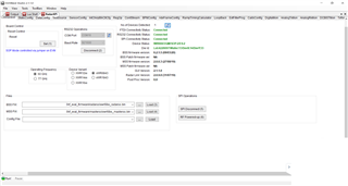

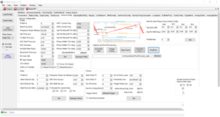

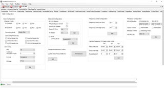

Attached are my configurations for mmWave studio.

    The issue here is not with your setup or chirp configuration, but rather with mmWaveStudio itself. With the mmWave Industrial Visualizer you are able to give antenna pattern information via the three parameters "antGeometry0", "antGeometry1", and "antPhaseRot" in a configuration file (.cfg). Between our different EVMs are different antenna patterns so the calculations for point cloud location will be different between EVMs. ODS has a very different antenna pattern compared to other EVMs and mmWaveStudio does NOT have a place to input antenna pattern parameters. The tool is mostly for raw data, heat-maps, graphs, etc. The point cloud viewer in it is sort of tacked on and not super reliable. What the device is outputting via point cloud is actually what is seen in the Industrial Visualizer, so the sensor is properly functioning.

    All commands from a tuning level and even almost all commands possible that is done in mmWaveStudio can be done outside of it. The mmWave SDK is what drives all functionalities, and so whether you are creating a .cfg file to tune the Radar or using mmWaveStudio's tabs change parameters, the knobs exist for both environments. The only thing that exists in practically only mmWaveStudio is raw ADC data capture. But if you look at the SensorConfig tab for example within mmWaveStudio, every single parameter there has a corresponding one in a .cfg file which is what is sent to visualizers such as the Industrial Visualizer. You can set the device to only run for X amount of frames and save all the data in a .dat file using the mmWave Demo Visualizer which is an in-browser visualizer.
