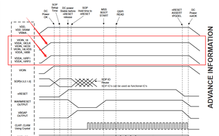

May I ask the power-on time of AWR2944? Are the second and third lines powered on at the same time?
Hey,
AWR2944 power up would start on release of nRST. Hence, it is user-dependent.
The second and third lines are outputs of the PMIC used on the board. For the Chariot PMIC used on TI EVM, the delay between these lines is ~1ms. It may be different for different PMICs.
