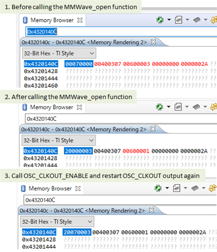

  • Hi  Nathan,
    The value of the register 0x4320140C is overwritten by the mmwave_open function call.
    Hiroyuki

  • Hi Nate,
    I set a breakpoint at the beginning of the function MMWave_openLink, stepped through it, and checked the register values.
    1. Before calling the function rlSetChannelConfig
            register 0x4320140C = 0x00070000
    2. After calling the function rlSetChannelConfig
            register 0x4320140C = 0x00000000
    3. Before calling the function rlRfInit
    4. Before calling the function rlRfInit
            register 0x4320140C = 0x20000003

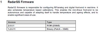

    I'm using the RadarSS firmware that comes with SDK3.5.0.4\.
            mmwave_sdk_03_05_00_04/firmware/radarss/xwr18xx_radarss_rprc.bin
    The figure below is an excerpt from the document mmwave_xwr1xxx_radarss_release_notes.pdf attached to SDK3.5.0.4.
    Hiroyuki

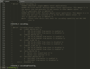

    As you've noticed, the configuration for the OSC_CLKOUT signal is considered to be part of the rlSetChannelConfig configuration. I believe there are two ways you can potentially resolve this.
    1. Edit the rlChanCfg struct being passed into rlSetChannelConfig to enable cascading and enable the OSCCLKOUT signal. I included a photo below of the relevant fields in the struct. I know these fields mention only being applicable to AWR1243, but I believe they should still be functional for the needs you have
    2. Enable the OSC_CLKOUT signal AFTER the rf channel cfg has already been completed. You can likely do the same steps which you are doing already, and as long as you do a read-modify-write, it should be safe to do so.

  • Hi Hiroyuki,
    Only Single Chip mode is supported for xWR16XX and xWR18XX devices in Channel Config API. The Channel Config API will enable the OSC_CLKOUT if the device is setup as Master (which is not possible for xWR16XX and xWR18XX)
    So unfortunately, Even if you specify cascading field to 0x0001 it will not be honored for xWR16XX and xWR18XX devices.
    OSC_CLKOUT needs to be enabled by a register write after the Channel Config API as you are doing.
    Nate
