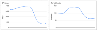

I have a problem with phase and amplitude when the material target changes. The sistem that I use is like this.
The OPT design is custtom design but it was previously calibrated and set to maximum current on HDR1 TX1.
When the target changes, phase and amplitude changes as is shown below.
This is the data set.
Phase, Amplitude

What is the problem with the signals? Is it normal?
Thank you!

  • Hi Daniel,
    Amplitude readings are pretty low in this data. What hardware are you testing on - is this an EVM? Is the target very far away? What is size of the target? Is there some surface behind the targets what can also reflect light to the sensor?
    I think what is happening is that if the OPT3101 FoV extends past the target then the phase reading is a weighted average of the reflections of the targets plus reflection from objects behind. Then if you change the reflectivity of the target it will of course change the weighting and thus the phase.
    Can you run the test with nothing behind the target and higher amplitude readings?
    Rahland

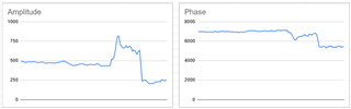

  • Hello!
    The low amplitude reading could be caused because I was using an optical cover glass, I'm using a custom hardware, The targets distance are about 1.6m. The targets are the floor, the problem with phase and amplitude is with the chamge of floor material. And there's not a surface behind.
    I have logged a new data set without optical cover glass and these were the results

  • Hi Daniel,
    Can you share a picture of the test setup/targets. There are two situations you are measuring - one with target 1 and one with target 2 - can you share a picture for each of these states?
    Alex
