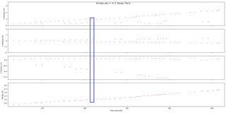

I’m using an IWR6843ISK to measure the falling velocity of a small object along the y-axis (directly away from the antennas).
The radar seems to be returning the data in pairs, and the spatial coordinates of the second sample in each pair seems wrong. The reconstructed range looks correct however, even for the erroneous second sample.
Below is a plot showing the X, Y, Z and Range values against Time, with one such pair highlighted.
Why do you think this is happening?
I've also attached the cfg if that's relevant.5_2_2_2_profile_2023_02_08T04_16_25_725.cfg
Aston
    I think you are referring to the detected points TLV, meaning there are multiple (2) points detected each frame. Is my understanding correct?
    Though based on your plots it seems that for some frames only a single point is detected. How small is the object which you are dropping and what material is it composed of? I'm wondering if it is reasonable to expect your object to generate multiple points or if it's possible that the second detected point is caused by some unwanted reflection.

  • Hi Josh,
    No, I'm meaning if you look at the data within the blue box it seems to be paired in the range plot however there are significant differences between the x, y, z, coordinates of the two points.
    In this test I'm dropping Sycamore seeds, so I think it's unlikely there are multiple reflections. The seed bodies are about 8mm in x and y.
    Can you tell me a bit more about your setup
    This was performed toward the centre of a large room, think community hall, with the radar held off to the side at the top of an aluminium ladder by approx 1m. Yes, this would be within the field of view.
    Aston
    Understood. I still would like to know what the pairs represent. How are you handling data for frames that contains multiple detected points?
    Yes, you are correct. Based upon the size of the seeds we would not expect to see multiple points; however, I'm wondering if we are seeing the effects of some multipath reflection perhaps off the ladder etc...
    Is it possible for you to run the experiment again without the ladder? Or could you modify the aoaFovCfg command in the configuration file (.cfg) such that the portion of the radar's FOV which the ladder obscures is not included? This way any potential unwanted reflections should be filtered out.
