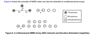

I am using awr1843 and I Have question about Virtual Antenna & Mimo Radar.
Case 1 :  From The documents "MIMO Radar" I found in figure 6.A : (picture below)
The antennas are like this : Tx1 and Tx3 in azimuth direction and Tx2 antenna in elevation direction and the 4 Rx antenna are all in azimuth direction.  (picture below)
=> so we wil  get 8 virtual antenna in azimuth direction and 4 virtual antenna in elevation direction ????

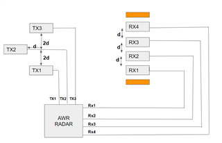

Case 2 : And if we put antenna like this : Tx1 and Tx3 in elevation direction and Tx2 antenna in azimuth direction and the 4 Rx antenna superposed in elevation direction.  (picture below)
=> so we wil  get 8 virtual antenna in elevation direction and 4 virtual antenna in azimuth direction ????
Can anyone confirm this information if it is true or correct it if there is an error?
