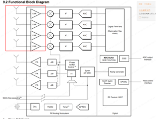

I use awr2243p support cascading mode, but I use signal mode (awr2243BG)
I get adc buffer is zone data
I use monitor is :

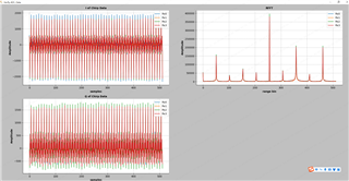

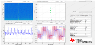

I only use awr2243 cascade chip CSI interface + codec + soc, but I encountered a problem that the adc data I acquired was relatively small,Close to zero ,
so I could not get effective data.

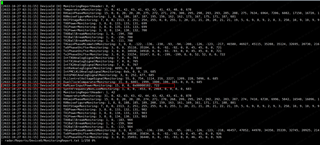

After that, I did some tests. The test pattern mode was used in 2243, and the soc side could collect the correct test pattern value. This verification showed that there was no problem with the following path. Find RxMixerInputPowerMonitoring: 15, 0, 0, 0 x00000000, 733, the adc voltage value is 0,
