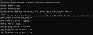

I flashed successfully the IWR6843ISK via MMWAVEICBOOST board.
I launched the vital sign demo but there are no data on the interface. Please se the Display prompt window:
Please for help

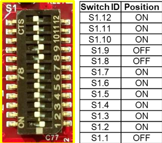

    Can you share with us your switch configurations? You must switch the device into functional mode after flashing and toggle the NRST button.

    Please my switch configurations for the EVM and MMWAVEICBOOST board in functional mode. Yes, the EVM works with the Out of the Box Demo without the MMWAVEICBOOST board. I tried to run the standalone EVM with the vital sign binary, but the labs doesn't recognize it. In the case of vital sign demo, The EVM must be connected to MMWAVEICBOOST board?
    The switch settings you have listed are for using the EVM in standalone mode. When using the EVM combined with the MMWAVEICBOOOST the settings should be changed to:
    S1.1: OFF
    S1.2: OFF
    S1.3: OFF
    S1.4: OFF
    S1.5: ON
    S1.6: N/A

    I also tried in EVM+MMWAVE ICBOOST mode the sent S1 settings (S1.1: OFF, S1.2: OFF, S1.3: OFF, S1.4: OFF, S1.5: ON, S1.6: N/A) and no data on the Gui demo.
    These are the correct settings for the IWR6843ISK EVM. Please also confirm that you have the correct settings for the MMWAVE ICBOOST board as seen in the image below.
    Additionally, once the correct settings have been applied for functional mode press the nReset button on the ICBOOST to ensure proper SOP mode is latched.

    The settings switch of IC boost is correct, the SOP is also OK. I press the NRST button after each configuration change.
    As I said in the first message, when running VitalSignsRadar_Demo.exe with EVM+ICBOOST, I get the following messages :
    "QMetaObject::connectSlotsByName: No matching signal for on_buttonBox_accepted()"
    That could be the root cause? no?
    Another cause: the version compatiblity !! Please check my versioning:
    mmwave_industrial_toolbox_4_12_1; XDS110; IWR6843ISK ES2
    Thanks for your support
  • Hi
    It's ok, That works. Thanks for your support
