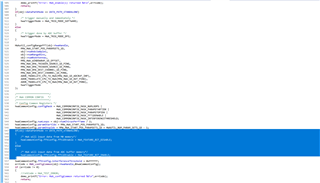

  • The following are the relevant functions related to HWA parameter configuration in the level_sense_demo project. The selected section (gray colour) is about the parameter configuration of pong. It can be seen that it reuses ping parameters, but only modifies the target address.

    Thank you for pointing out the relevant code. Just to confirm we are looking at the same example project, can you let me know which version of the Toolbox you are using?

    After reviewing the code I'm inclined to agree with you. It seems that under this HWA configuration the same processing is being done on the same data for ping and pong. I am trying to confirm this through debugging.
    When the project is actually debugged, gMmwHwaMemBuf[1](0x52034000) has no data, and the data of gMmwHwaMemBuf[0](0x52030000) is all full. Why is it full here? The project configuration is 2CHIRP, 1frame, 990 samples per CHIRP with 4 bytes per sample.
    Can you please let me know where you have placed a breakpoint? I agree based on the expected size of the data it should not be full. I will try to debug the same on my end.
    chirpThreshold=1, does this mean that DFE adopts multi-chirp mode? Secondly, I would like to know if the DFE trigger signal in HWA refers to the interrupt signal in the figure below?
    With chirpThreshold=1 an this means that after 1 chirp the ping/pong buffer will switch. The interrupt signal in the figure you have shown is generated every time the buffer switches and yes it does in turn trigger the HWA.

  • I set the breakpoint after HWA processed the data. According to the ping and pong processing methods, M0 and M1 should contain ADC data for chirp 1 and chirp 2 respectively, and M2 and M3 should contain corresponding FFT data. Currently, it shows that M0 has too much data, M1 has no data, and M2 and M3 seem normal.

    I have not yet been able to replicate this on my end.
    Please allow me some time to step through the code and investigate your findings. You can expect a response within 48hrs. Very sorry for the delay here, your patience is appreciated.
    Josh
  • Please give me a replay, Thank you
    I have been able to debug this on my setup. I can confirm that I see the same result as you. M0 appears that it is full; however, this only appears to be the case because the memory is never initialized to 0. Each time this is filled it should only be filling up 3960 bytes (990 samples * 4bytes each). If you watch closely using the memory browser around the address 0x52030000 + 0xF76 (0xF76 equating to 3960 bytes), you can see that the addresses past this are not being updated.
    As for why the source address is the same for both ping and pong processing; for this device, the ADC switch between PING and PONG is seamless to the application which always reads ADC data at the same address (ADC buffer address). This can be seen in Figure 2. of the Datapath Programmer's Guide.
