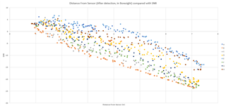

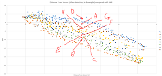

    For example, the following figure represents 8 Sensors (A-H) in tracking performance. Whereby the sensor was allowed to form a track, then the SNR was saved and compared to the distance, with the target walking up and down the boresight.
    To note, SNR here is calculated as the mean of the SNR readings reported for the target. Then this mean is multiplied by 10 to return the 0.1 steps back to their dBm value. Finally I added a minus sign, as the SNR values were increasing as distance got larger which is opposite to what should occur.
    Hence, SNR = -10*Mean(target's point cloud SNR values).
    From the above graph I was expecting to be able to predict detection area as there would be lower limit for the sensor to detect targets based on the SNR as provided in the config file. But unexpectedly, this was not the case.

    Strangely, the SNR values in the figure above suggest that C (Grey dots) would be a high performer as it has SNR readings (during the tracking test) just below B, and above F and G.

    On the original graph used for tracking these SNR reading look like this:
    Most of the sensors RC readings at 3m matched their trends from tracking. D however was vastly different.
    Happy to send you the configuration file used in an email along with hardware details, elevation, angle etc.
    Based on my findings, the SNR value is not effective at estimating the detection area, and the only real option is a series of CR's. But this does not form a measurement to identify where this variability comes from or why simply some sensors are better than others.
