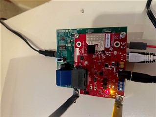

I am trying to get hardware connection for DCA1000 w/ AWR2243BOOST mmWave Sensor EVM going. Able to connect microUSB and Ethernet cables to the PC interface, as shown below. The DCA1000 and the AWR EVM are powered with 5-V, 2.5-A supplies.

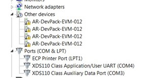

As per mmwave studio user guide, when the DCA1000 EVM is connected for the first time to the PC, Windows maybe not be able to recognize the device and would come up as ‘Other devices’ in device manager as shown in below Figure.

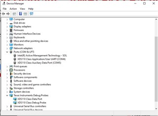

But in my case I am not able view any of the AR-DevPack-EVM ports on power up. I see only XDS110 COM’s being detected. COM port shown are XDS110 Class Application/User UART, which are part of code composer studio installation EMUPACK. Searched out other sections under device manager no where I can find these COM's being recognized.

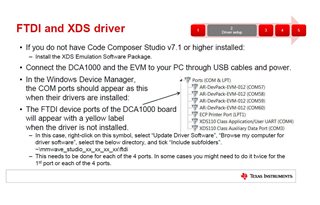

Per quick start guide, eventually after FTDI USB Drivers installation from mmwave_studio packages, below should be viewed in ( COM  & LPT ) ports within Windows Device Manager. I also tried to looki at follow what is being mentioned in mmWave_sensor_raw_data_capture_usingDCA1000_AWR2243.pdf it says below details on slide 11, but I don't see this options coming up in my case.
Question, why I am not able to detect any of the AR-DevPack-EVM com ports? After powering up DCA 1000 EVM and AWR2xxx BOOST-EVM ( Tried out few options, rebooted my laptop +  performed several power cycle retry’s on EVM’s ). No luck with  Devpack COM ports being recognized.
