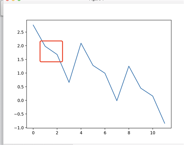

The customer uses AWR2243BOOST+DCA1000 to capture radar data and measure an angle reflector in an open field.
Using their own script to read the bin file and the range-dopper situation is as expected after rangefft and dopper FFT. However, when extracting the phase of data at the corner reflector location (as shown in the figure below), RX2 has a fixed offset compared to RX0 RX1 RX3 phase, which is not as expected for periodic phase change. Although anglefft of the current signal can give an approximate correct angle position, the customer is concerned that this offset may affect the accuracy of the final angle.

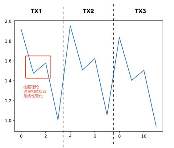

The following vertical coordinates are phase and horizontal are 0-12 (after using MIMO-TDM, respectively):  [ TX0-RX0 , TX0-RX1 , TX0-RX2 , TX0-RX3 , TX1-RX0 , TX1-RX1 , TX1-RX2 , TX1-RX3 , TX2-RX0 , TX2-RX1 , TX2-RX2 , TX2-RX3 ]

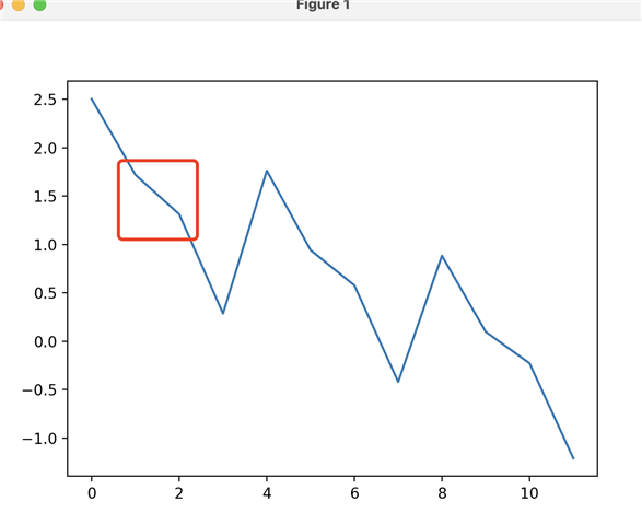

A similar behavior occurs when testing other groups:
And the customer found here's something called RX calibration, while don't know how to do this on mmWave studio. Could you please help look into this case? Thanks.

  • Hi Cherry,
    We checked on this query with our team internally and we need some clarifications here on this query.
    1) The plots which are shared can you let us know about y axis is in which units (degree or radian)
    2) Rx gain calibrations will not help in resolving these phase issues.
    3) It may be also due to mismatch at the antenna level. Can you check with the customer and get us more information on their antenna placement and alignment.
    Pradipta.
  • Hi Pradipta,
    Radian.
    May I know the reason?
    The customer is using the awr2243boost single chip.
    The antenna arrangement should be fixed and no special processing was done, but simply modified the DataCaptureDemo_xWR.lua in mmstudio to a MIMO-enabled mode.

  • Hi Cherry,
    We checked on this query with the team internally. Please find our comments below.
    Q) Rx gain calibrations will not help in resolving these phase issues. May I know the reason?
    Comment) RX Gain Calibration applies the optimum RX LNA Settings and RX IFA settings, based on RX Gain measurement results, temperature and profile’s RX Gain setting, which is same across all 4 RXs. Hence, it can not help mitigate the phase difference across RXs.
    Q) It may be also due to mismatch at the antenna level. Can you check with the customer and get us more information on their antenna placement and alignment. The customer is using the awr2243boost single chip. The antenna arrangement should be fixed, and no special processing was done, but simply modified the DataCaptureDemo_xWR.lua in mmstudio to a MIMO-enabled mode
    Comment) Customer can consider measuring phase for RX0,1,2,3 with corner reflector at angle=0. With this, they can find the offset for each RX and calibrate the offset during actual field measurement.
