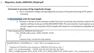

    We tried ES2.0 in 2944, and found that there are some issues when trying to use zero-insertion function of HWA, in migration guide of ES2.0, we found that there are some updates about HWA, and we found two problems:
a. In this document, it says"Increase in the bits of zero insertion number from 8 to 11",but we found in SDK, the bit of number is still 8
b.we can't config zero insertion mask registers as what we want, only the first 11 of the 16 bits can be configured.

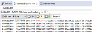

   we try to config a 0xffff into DSS HWA DEROT RAM, but we only read 0x3fff in this RAM

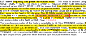

    I don't have an ES2.0 EVM in my hand, but I quickly checked this problem on my ES1.0 EVM. The problem is the same as customer.
    The highest two bits for each half word are always zero no matter what value you set in DSS_HWA_DEROT_RAM. In HWA data sheet, I found below words.
    It said top-most two bits are not cared in DSS_HWA_DEROT_RAM, which matches current behavior. Could you check with design team which is correct definition of this RAM space?

    I've been able to see 0x3FFF upon writing in both ES1.0 and ES2.0. Will get back with an update from the design team.
    Kaushik
    I've discussed with the design team and this incorrect readback value from the DSS_HWA_DEROT_RAM is a known issue (will be updated in the upcoming errata). The RAM will be configured with whatever value is written by the user and the functionality is expected to be unaffected (has been verified by our validation team). Please try configuring the HWA according to your use case and let me know if there is any issue.

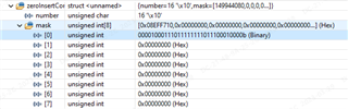

            b. Is this point only for ES2.1? Because in ES2.0, we didn't set to 1 of the mask MSB, but it can run successfully. our mask is:0x08EF3710 ,others are zero.

    1. The MSB I'm referring to is the absolute MSB of the entire bit mask starting at the address of the DSS_HWA_DEROT_RAM. This corresponds to the last same that would be passed out from the input formatter. Need to make sure that there are no zeroes preceding it.
    2. For both the versions of the devices it is recommended to set 1 for the last sample. (Also mentioned in the user guide).
    3. Yes. Referring to the very first bit MSB of the mask. It is better not to interpret this RAM as 16 bit or 32 bit words. Rather look at the memory bit by bit directly from its start address.
    Ideally your bit mask would have to be of the size (ACNT + Zero insert num) bits which will be the new number of samples after zero insertion. (This is also mentioned in the TRM)
