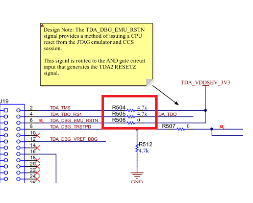

MMWCAS-DSP-EVM: The resistor values in R505 and R506 are different in between schematic and BOM files.
Part Number: MMWCAS-DSP-EVM
Hi TI expert,
 While checking the design file "PROC055A Cascade Radar Host Design Files (Rev. A)" of MMWCAS-DSP-EVM, (the TIDM415A.ZIP) under https://www.ti.com/tool/MMWCAS-DSP-EVM#design-files. We find that in the schematic, it uses R505 == 4.7k, and R506 == 0 ohm as below picture. However, the BOM file "PROC055B(001)_BOM.xls" under the same design file shows reversely as R505 == 0 ohm, and R506 == 4.7k.
 Which one is correct? We suppose the schematic making wrong, and BOM file is correct, right?
