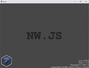

  • Hello Ricky,
    thanks for tackle down this issue.
    To your 4th point. Is UniFlash supposed to start by nw.exe? If so, it does not work. Start-up freezes at following overlay.
    Kind regards
    Philipp
  • Yes, you can start UniFlash via nw.exe, but you need to pass it the path to the UniFlash install as the first parameter. The '.' in my example command would handle that if it was run from the install folder; but if not, you can also pass in the full path manually.

  • Thanks for you patience, I overlooked the "."
    The log is attached. I tried several precompiled .bin, same result for all of them.
    BR

  • Philipp,
    Thanks for providing the logs. It provided a little more info on where exactly the hang is happening.
    In your original post, you mentioned that it was working for you before; do you remember what might have changed on your computer when it stopped working?
    UniFlash is executing a python script to handle the flashing logic, and it seems like it is getting hung up on that step. So I'm wondering if there is some process or new security policy blocking that call or something similar.
    Ricky
  • Ricky,
    I use Python on a regular basis, so I did not expect any issues here.
    Nonetheless, I cleaned my Windows PATHS related to Python. After reinstalling Uniflash 8.2, I am able to flash my xWR again.
    Thanks for your help.
    Philipp
