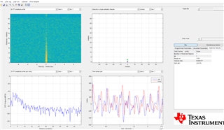

I want to check the noise coming into the RX channel using mmwave studio.
So I connected IWR6843LEVB and DCA1000EVM and checked using mmWave Studio, and it came out as below.
Data sensing does not work in real time. And what data do you use to check the noise coming into the RX channel?
    DCA1000 and raw data is not supported in real time. The purpose of raw ADC data is to acquire the unfiltered, unprocessed IF signal and then create processing chains of your own. What is your application and what kind of data are you trying to get? If you want noise data then you can look into the noise profile which can be provided via out of box demo. If you are curious on what kind of data out of box demo provides, check here: https://dev.ti.com/tirex/explore/node?a=1AslXXD__1.00.00.26&node=A__ADnbI7zK9bSRgZqeAxprvQ__radar_toolbox__1AslXXD__1.00.00.26

  • Are you looking for the noise figure values? Noise profile? Signal-to-noise ratio? I am going to guess noise profile and you can use the Out of Box demo source code binary, flash it to the binary, and use the online mmWave Demo Visualizer to visualize the noise in real time. You can compare the 6843ISK vs your own module this way.

    First you will need to download the Radar Toolbox which will provide you with all source code and documentation.
    Second,
    The IWR6843LEVM's antenna pattern matches IWR6843ISK, so going forward know that any lab that supports ISK will support your EVM as well. You can find the binary at:
    \radar_toolbox_version\source\ti\examples\Out_Of_Box_Demo\prebuilt_binaries
    Flash the binary using Uniflash, then go to the online visualizer page:
    https://dev.ti.com/gallery/view/mmwave/mmWave_Demo_Visualizer/ver/3.6.0/
    And you can turn on an option for noise profile.
