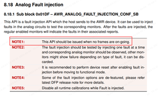

Refer to the mmWave Radar Interface Control Document  8.18 Analog Fault injection,  I want to use the fault injection API function to inject faults and get the error infomation.

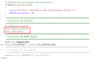

  • And all of these operations are executed in MmwDemo_initTask, before triggering the frames.
    Where exactly have you put up the custom code in the initTask function. Can you provide screen shot of the error you are facing.
    Pradipta.
  • OK, custom code is in the red box.
    And the assert infomation is as shown in the following screenshot.
    So currently your code has not stated the scheduler which is started after the end of the MmwDemo_initTask. So, the task which was created in this API call to handle the communication with the Radar Subsystem is currently non-operational. Hence when you are getting an Async event you have no task to handle the async event. Thus, your application is going into an asset.

  • Ok,I will try your suggestion, but in the manual, it requir that the API should be issued when no frames are on-going, if  I use the scheduler to execute the task, it may affect the RSS or other module.
    Currently there is no active task to handle the communication between the Radar SS and your MSS/DSS. That is where your execution is getting stuck. The fault injection API is to communicate with the RSS. So you will need that in your application. I can suggest you write your own custom application to check this feature. You can refer to the latest SDK package from our website. It contains the DFP package as well which has a test example which you can refer to code your custom application.

    Please follow this sequence in your code.
    1) Configure and Enable the monitor where you wish to inject the fault.
    2) Do the fault injection.
    3) Trigger a frame.
    4) After the frame is ended you will receive a monitoring report. Check this report to verify the fault injection. After the faults are injected, the
    regular enabled monitors will indicate the faults in their associated reports.
    5) Remove the fault.
    You can use these steps above for each fault injection you want to observe.
