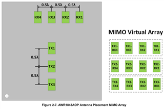

Hi Expert,
Customer want to know what's the antenna polarization on AWR1843AOP? Thanks.
Allen
Hi Expert,
Allen
The antennas are fed horizontally from the left side.
