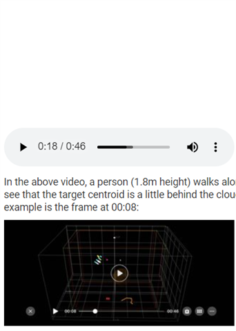

  • Hi Nate,
    This is the video tha we talked about.

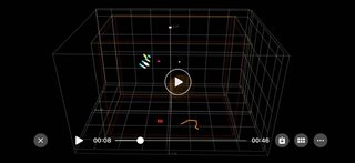

    In the above video, a person (1.8m height) walks along with the x-axis back and forward and keeps as steady as possible during the wall. We can see that the target centroid is a little behind the cloud points generated by the person and the target is not output when crossing the boresight. An example is the frame at 00:08:
    Tony

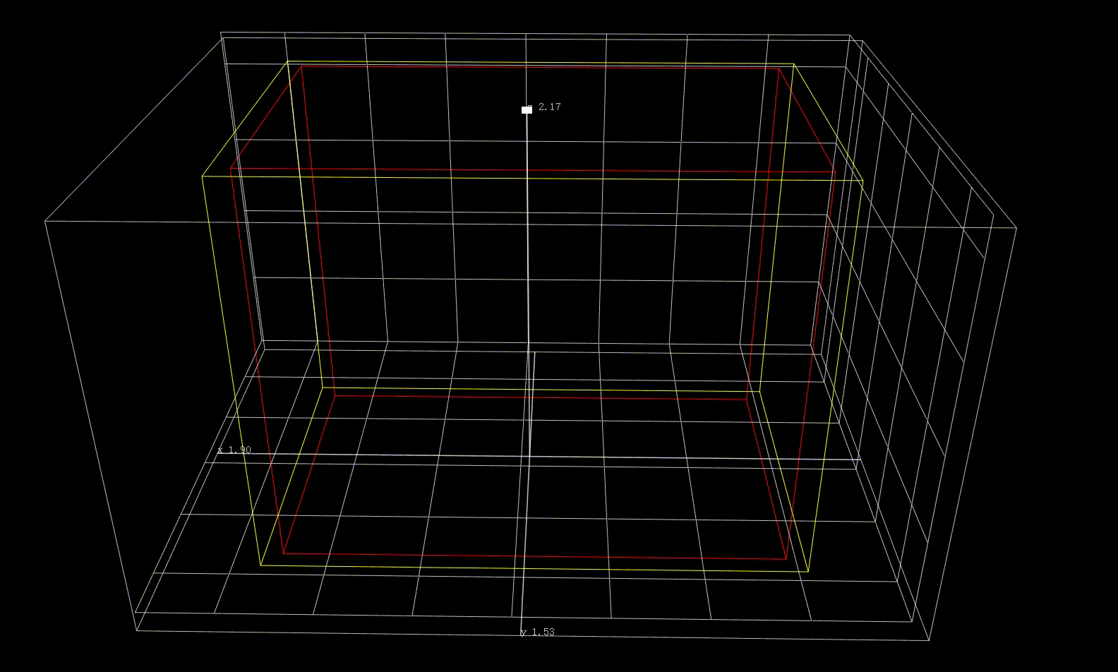

  • Hi Tony,
    Can you describe what the spheres and the cubes indicate in your video? I'm not quite sure what I'm looking at here. I surmise the multi-colored dots are the point cloud, but what about the orange and yellow spheres, as well as the boxes?
    Can you also please send the entire configuration used?
    Nate
  • Hi Nate,
    The cube presents boundary boxes defined for tracker, presence, static and dynamic respectively; the sphere represents the centroid of a target; the grid (0.5m internal space) represents walls and the floor; and 8 frames of points are accumulated and tinted in different colors. In addition, the color of a cube will be changed after a new target is reported from radar, along its trajectory on the ground.
