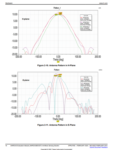

AWR2243BOOST: Question about antenna pattern of AWR2243Boost
Part Number: AWR2243BOOST
I want to know Antenna pattern(radiation pattern) of the AWR2243boost's Tx and Rx respectively.
I already checked user guide, data sheet and found the below figure which suggests antenna pattern.
I want to know more specific antenna pattern which shows 3tx and 4rx respecitively.
I searched all of the documents but I cant find it.
Could you give me the data or plot of antenna pattern please.
Thank you.
    Unfortunately I could not find any other plots related to this board.  But what you can do is take the board file and import it into HFSS and run the simulation yourself.  You can generate all the plots you need about this design.
