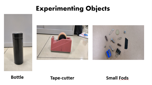

I'm working on my final year project on Detecting Foreign Object Debris (FOD) by AWR1642BOOST. currently my goal is to show the highest distance at which the small Fods will be detected.
While experimenting, I have seen, the larger objects like water-bottle, Tape-Cutter etc. can be detected accurately, i.e., statically I can see a rich point in the XY scatter plot and also the point was moving accordingly while I moved the object.In this case I can surely assume that this point is for that object, that's why I can accurately measure the distance.
But when I'm taking some small objects (like FOD), I'm not getting that rich and accurate point like I was getting in-case of Larger Objects, Detection points are blinking and sometimes it's going and coming, also while moving the object, points were gone, coming for some seconds. In this scenario, I can't measure the maximum distance at which the FOD will be detected.
Below I have attached some of the experimenting objects.
Reference - www.ti.com/.../swra593a.pdf
anyone, If you have some hint, please share with me what to do. It'll be really helpful for me.
