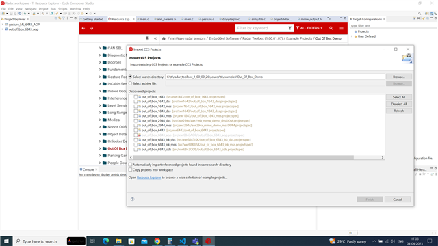

   I wanted to build the source code of Out of Box demo code written IWR6432Boost, which has Cortex-M4F processor.
But i am unable to find the code for IWRL6432.
Screenshot attached as below :
Please let me know how can i get OOB code for IWRL6432BOOST.
    For the IWRL6432, the Out of Box demo code and .projectspec file (used for importing CCS projects) are both located in the mmWave SDK v5.x this is different from our previous generation devices where the .projectspec file is stored in the Radar Toolbox. Sorry for the confusion here.

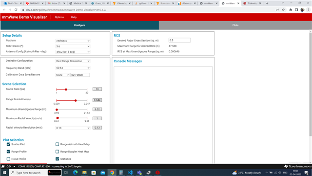

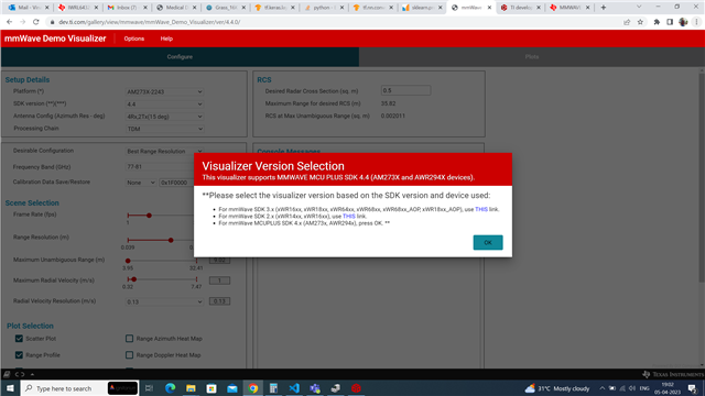

    But when i went to demovisualizer, i dont see the demo visualizer supporting IWRL6432BOOST device, as shown below :
    SHould we use XWR64 series one ?
  • Even XWR64 series  seem to have trouble connecting to XWRL6432BOOST.
    Can you please help me to run sample code and visualize Radar RD-map, profiles etc.
    The mmWave Demo Visualizer on dev.ti.com does not currently support the xWRL6432. You can run sample code and visualize the radar data with the visualizer provided in the mmWave SDK 5.x ({SDK_INSTALL}/tools/visualizer).

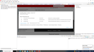

    But the prerequisite that it is asking for SDK version is not available at your site.
    i.e : MCU_PLUS_SDK_XWRL64XX with version number 5.00.00 , whereas at TI site, we have version starting from 5.01.
    I have installed 5.01 , but this version difference would be good to check.
    That appears to be a mistake. Radar Toolbox 1.0.1 is supporting mmWave SDK 5.1. Sorry for any confusion and thanks for bringing this mistake to our attention.
