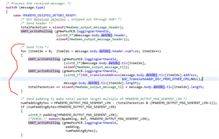

  • Hi Matthew,
    Great! So you have probably seen the data output structure in the lab, it looks like this:
    To modify this lab to send out the data over SPI you will need to open this lab in CCS and modify the lab itself and build a new custom binary image for your use case.
    This data packet is sent in mss_main.c under the comment /* Send TLVs */
    You would need to modify this to use the SPI driver instead of UART. Then you would choose to only use the information you need from the vital signs TLV for your gui.
    Angie
